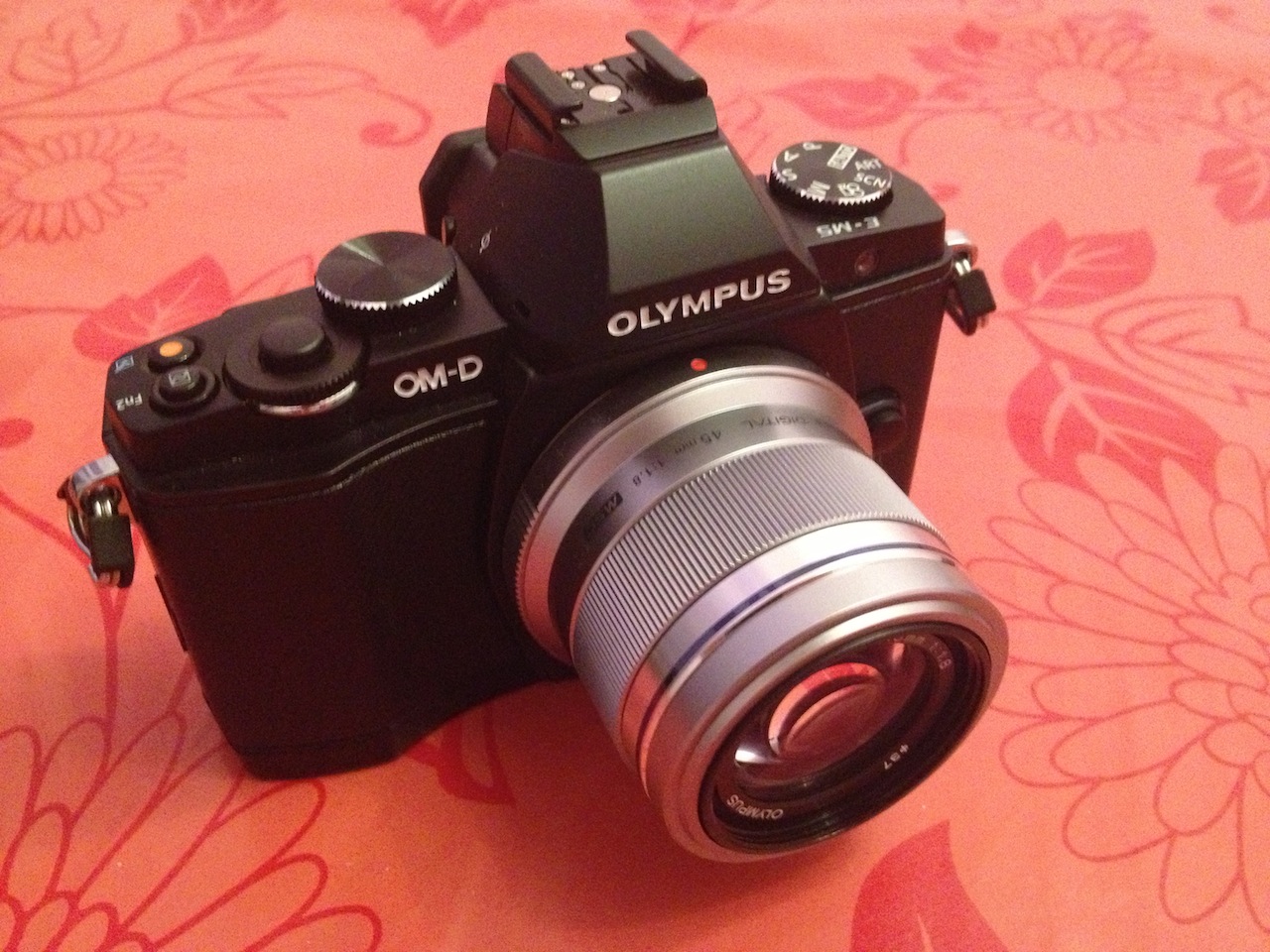

De azi am redevenit user olympus. Bye Bye Sony... OM-D a revenit
Hurray!!! Wink
